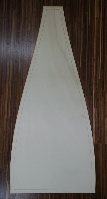

PS: Schnittschablone for Faule (Chute Maker -> Inkscape -> Laser Cutter)
