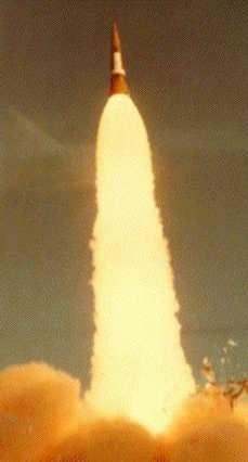

Beitrag 7237 , High Boost Experiment [Alter Beitrag17. Oktober 2001 um 15:02]
ich erlaube mir, von dem weiter oben zitierten Link zu schmarotzen:
<font face="Times New Roman">
If you thought Sprint was a phenomenal missile, HiBEX was even more interesting in some ways. It was part of a project called Defender run by DARPA in conjunction with the Army for a last ditch ABM missile in a similar vein to Sprint. However, it was literally a last ditch missile and was designed to intercept an incoming RV at less than 6,100m (20,000ft) altitude. At that altitude, the incoming RV would be traveling at around 3,000m/sec (10,000ft/sec) so a very fast reaction time was essential to insure interception. In fact, HiBEX was designed to have exited from its silo within 1/4 second and it <b>accelerated at over 400g</b>.
HiBEX was only 5.2m (17ft) long and due to the high acceleration, the fuel did not last very long at all, so it was characterised with very short rocket burn times and hence a very short range. One of the problems with such a high accelerating missile was that of guidance, and the onboard gyros presented a problem. Mechanical gyros were not really practical due to the spin up times and flight characteristics (ie they took to long to spin up, and didn't take kindly to rapid shifts in trajectory), so ARPA developed the laser gyro. This meant that the gyros and associated guidance system was available essentially instantaneously permitting a very rapid launch which was a major design goal.
</font>
7 Testflüge 1965
Bertram

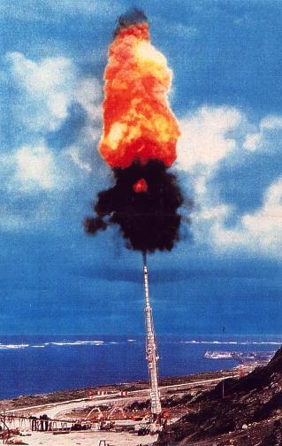

Beitrag 7263 [Alter Beitrag18. Oktober 2001 um 23:45]
Abschuss einer Martlet-3:
Jules Vernes, wir kommen!
(Die Amis spinnen zwar, aber auf echt hohem Niveau!)
Beitrag 7266 [Alter Beitrag19. Oktober 2001 um 08:15]
bei dem letzten Bild hat sich mein Verdacht bestätigt. Es ist eine von den Bull Kanonen. Bull war einer der versucht hat, mit Kanonen ins Weltall zu schießen, oder eben sehr weit. In einem PM-Heft ist ein Artikel dazu. Er hat glaube ich bis zu 180km Höhe erreicht. Allerdings war in dem Artikel nie die rede von Raketen gewesen. Es war mehr ein Geschoß was wie eine Rakete aussah. Das war auch nötig, weil man bei dieser starken Beschleunigung, dem Geschoß keinen Drall mit dem Lauf verpassen konnte. Das Ding steckte sozusagen auf einem Riesenkorken. Gedacht war das, um Raumstationen zu versorgen, also Beschleunigungs unkritsche Sachen.
Bull wurde angeblich von einem Geheimdienst umgebracht, weil die Befürchtung da war, das er für den Irak die Superkanoe bauen würde.
